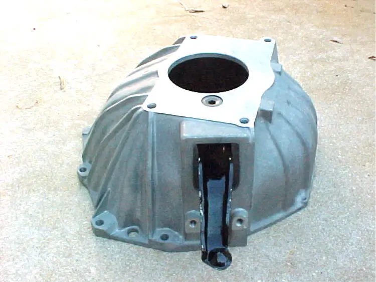

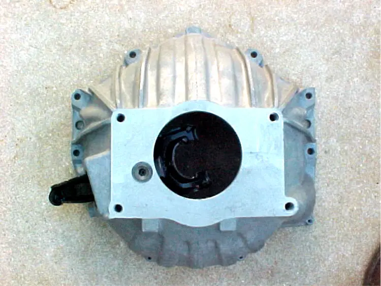

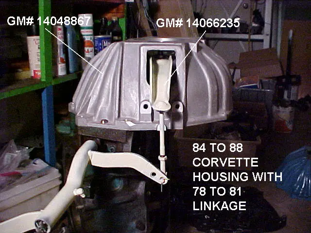

Check out THIS LINK and the pics below (same site):
Apparently the '84-'88 Vette bellhousing lines up just peachy with the G-Body linkage. I don't know how rare these bellhousings are though, so it may be a ghost hunt, I can't be any help there. But, since I'm here and I know you're looking for an 11" bellhousing...
CHECK IT OUT :) I'd remembered seeing a repro 11" bellhousing somewhere, and OPGI came to mind. I believe I'd seen one somewhere else as well, BUUUUUUUUUUT I can't be sure.

OPG says they have an 11 inch Gbody bellhousing but when you call them They know nothing about it other than they know they have it. No specs No manufacturer

I have spent the last week looking at every possible combo for the G-Body.
There are options for bellhousings. None are feasible for a stubborn a$$hole like me though. While the pics you show me look great..good luck finding that stuff. I have seen that pic and hunted that bell as well. The only real options are:
1. keep the stock 606 casting and hunt down a 454 flywheel that has 153T, this is near impossible. Very few options that are not expensive.
2. Hunt down the elusive bellhousing that is for a G-Body that is capable of handling the 11" clutch. There are none to be found.
3. Use a Lakewood scattershield. None of them come from the factory that dont need crazy indexing and I am just not wanting to play with dowel pins and shell out mega bucks for that AND an expensive clutch.
