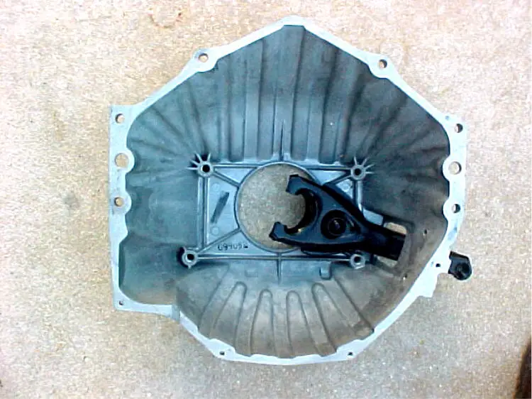

Check out THIS LINK and the pics below (same site):
Apparently the '84-'88 Vette bellhousing lines up just peachy with the G-Body linkage. I don't know how rare these bellhousings are though, so it may be a ghost hunt, I can't be any help there. But, since I'm here and I know you're looking for an 11" bellhousing...
That '84-'88 Vette bellhousing -# 14048867 is a 10 1/2" bell.
